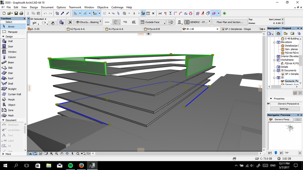

So here's the problem: I've got an urban project where I've got several buildings around that were first created with very thick slabs and put to layer "- Turiai" (eng. masses). Now it is time to detalise those buildings and here's the thing - I have some walls or curtain walls drawn in a floor plan and they show up there as usual but in a 3D view i can sometimes see part of them and sometimes i can't see them at all depending on where they are (sometimes the selection might be visible but not the wall itself). The walls are in basic "Structural-Bearing" layer It seems like there are some invisible objects that are hiding everything else in their way (except slabs). I've tried turning layers on and off, tried the renovation filter thing.. The same thing happens in other places of project.

Couldn't add 2 pictures so here's the other one.

lapemiau:
Even items on hidden layers can affect the visible model. Check to see if hidden elements are intersecting the model where visible elements are not showing. You can change the Layer's Intersection Group Number to prevent this.
