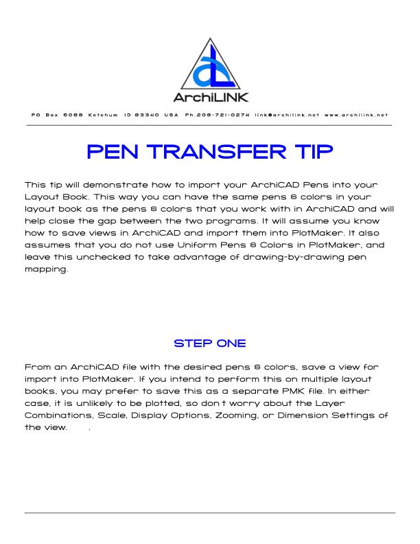

I have never seen why we would want different pens & colors in our PlotMaker layout books than in our ArchiCAD projects. Here is a simple tip to get your ArchiCAD Pens into PlotMaker.
As always, if you'd like a copy of this in PDF format, please contact me privately with your email address. It is only 765Kb so shouldn't be a problem for most users.

It seems that you have either answered your own question, or you change the scale globally when you plot to 3/16". A drawing that is placed on a sheet may have any pen mapping you want (as long as you're not using uniform pens & colors). Otherwise you can scale the pen weights with the globally (re)scaled plot file, by editing your registry as described here: http://www.graphisoft.com/support/archicad/archiguide/ScalePenWeightinPM.html
Can you also import different line types and fill types into plotmaker from Archicad?
Not using this method Millard, but I am sure there are multiple workarounds for this. One way is to import a PMK that contains the linetypes & fills into your layout book, open it, and copy & paste the elements onto a sheet.
