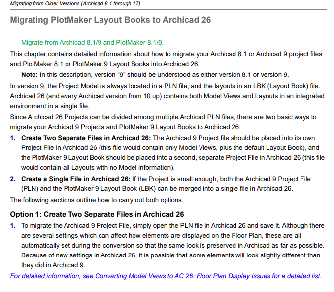

One for the Way Back Machine, but I'm trying to open a LBK file from Archicad 11 using AC 26 but AC26 crashes every time.
Anyone have any thoughts on how I can open this old LBK file?

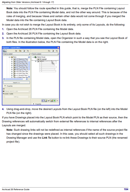

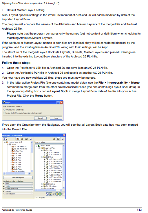

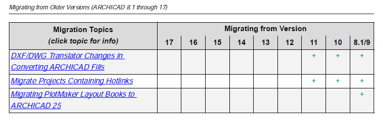

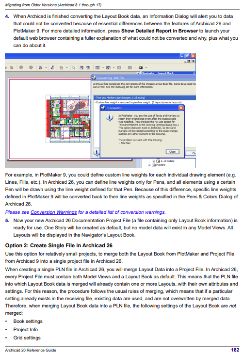

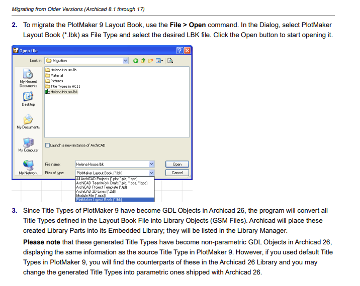

Try Archicad 25
https://help.graphisoft.com/AC/26/INT/Archicad.pdf
i don't know if going to an earlier version will help.
