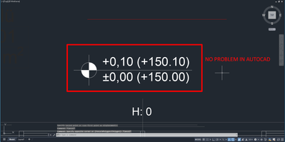

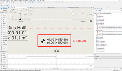

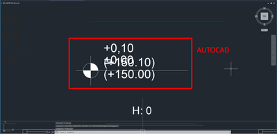

When converting from Archicad to AutoCAD, if you add text to level dimensions manually, that text appears as two lines in AutoCAD for some unknown reason. Manually adjusting this text in AutoCAD to make it a single line is quite difficult.

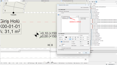

Here’s the solution I came up with:
If you add a space at the end of the line of text you’ve added by pressing the space bar once, there won’t be any issues during conversion.
As far as I understand, the text gets cut off because a trim operation is applied during conversion, but by adding a space, you’re leaving a safe margin for the trim.
