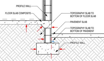

Hello,
This topic was discussed four years ago (Overlapping Mesh Cut Lines in Sections...), but I am really struggling with this issue now, especially since it used to work in my previous templates AND in Version 24.
Please see attached screenshots.

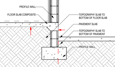

In a scenario like this usually we didn't even need to do SEO, just played with the display order.
Now doing SEO makes it even worse.
Could somebody shed some light on why those lines won't show up and what is the logic? They seem to happen randomly, why is the one with the blue arrow there then?
The elements are not the same building material, they are on not intersecting layers, as well.
I recreated this section in my old template and realized, if I select any elements, the lines similarly are missing, however, the touching element's line shows in full, so it is not noticeable and prints perfectly.
Thank you, as always!
