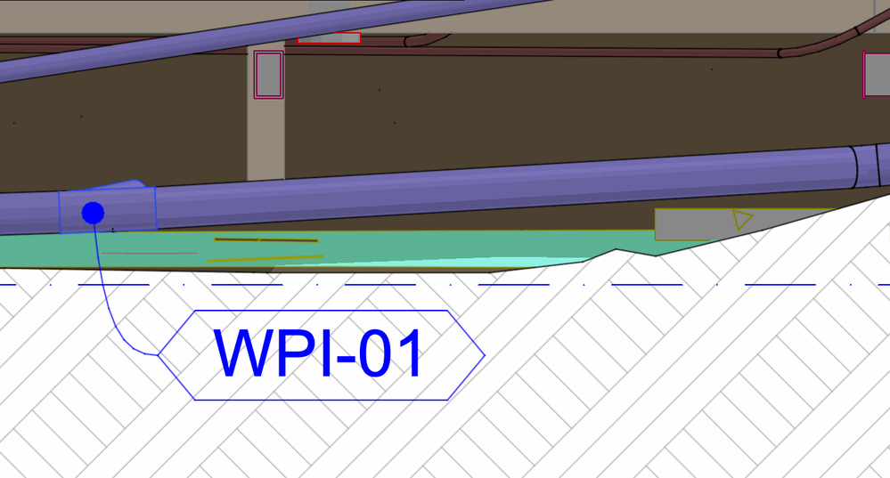

Marc H
Ah, the saga of the MEP tool.  I came up on this problem a few months ago, too.  My need is to have the pipe segment show in scheduling without all the baggage of other associated components. I also experience an RS status issue when connecting new pipe to existing pipe wherein it wants to marry the two sections together.  I also have some SEO operations in which the piping will not participate.
This may not work for your needs, but for mine, I’ve made a morph of a pipe connector, set it at the POC, and with that element in place, applied an ID autotext label.
Hope it helps.
