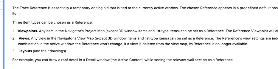

trace reference files not showing when i create a new view layout and can't seem to figure out why? do i need to place all of my elements in a dummy model view to show in layout view?

The drawing you place on a layout does not contain the trace reference if you have set one for the view you are using to place the drawing.
The trace reference needs to be set (placed) in the layout, just as you would for a view or view point.
The reference will be linked to the layout and not the drawings on the layout.
You can reposition the reference to overlay any of the drawings.
You can have only one reference on a layout, so if you have more than one drawing in that layout, you can only have a reference that suits one of those drawings.

Hi @Zdenko
I cannot understand you very well... but just to remember:
"When you place a Drawing onto a Layout, the Drawing content will not include the Reference."
Also you can check if all your elements are visible on the trace reference:
And anyway you could review this, just in case we missed something: https://help.graphisoft.com/AC/27/INT/index.htm?rhcsh=1&rhnewwnd=0#t=_AC27_Help%2F030_Interaction%2F...

ok looking at the link it tells me i can reference but then it tells me i can't? i would like to show the first floor with the foundation as a reference in a layout so i can publish and send to other team members. am i to assume that ac is purely driven by layers and layer combinations?
