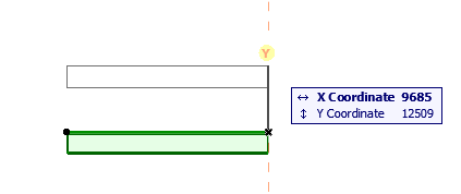

Recently I did something and my tracker seems to have had something changed and I cant figure out what I did.
Usually id just grab something, CTRL+D to drag it, then type say 500 and ENTER and it'd move 500mm along that axis.
Now it doesn't do this, it will usually display a much larger number and im guessing moves it to like 500 from the center of the project?
Using X then 500-/+ still works fine for me to make a guide line where I want to go... but i miss being able to just move things by typing a number and it moving that amount in the direction I want it to go.
Not sure if attached picture will help or not.
Thanks.

Look for the command Relative Coordinates in Tracker, it should be active (checked).

I had it on active, had tried turning it on and off and does not seem to affect anything
I have also updated my signature.
Could there be anything else maybe causing this issue?

Thanks for adding the signature. You can also look at the options under Work Environment > User Preference Schemes > Tracker and Coordinate Input.

That helped! I found that under "Coordinate input logic:" that a box was checked which was "Show X-Y Coordinated relative to User origin in Tracker"
Unchecking this fixed the issues I was encountering.
Thanks!
