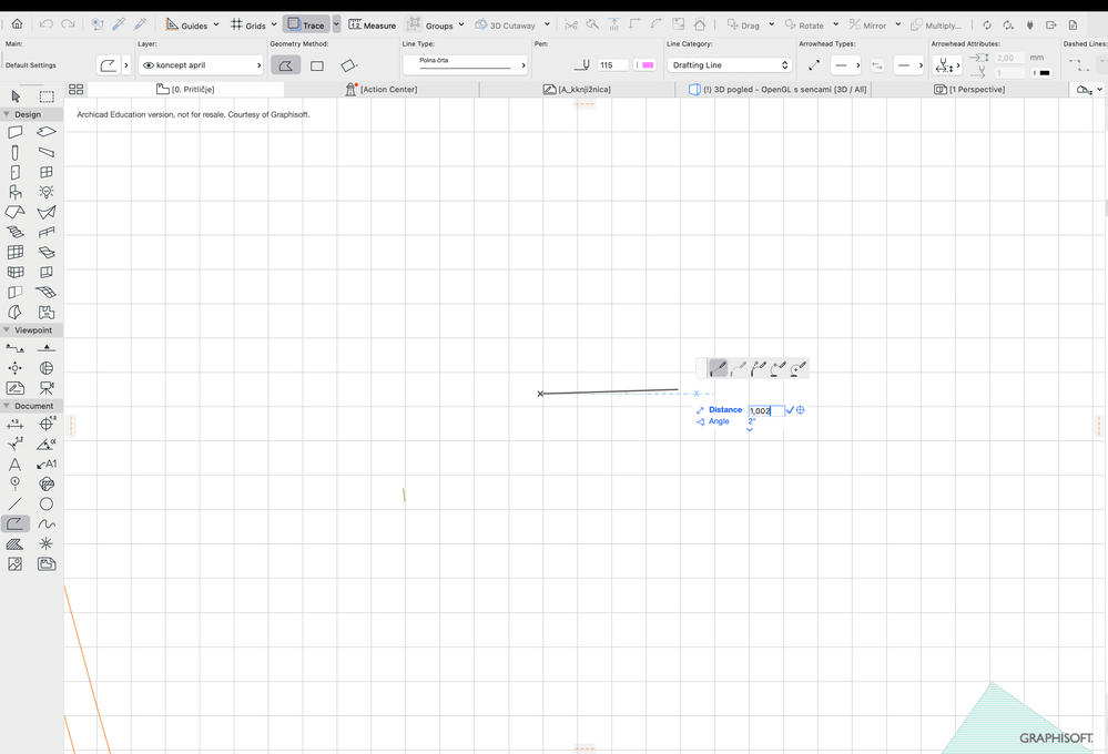

Hello,
I have been facing a small issue regarding the basic Dimensions input. Since I started using Archicad - first time 27 - I enabled the option in Work Environment > Tracker and Coordinate imput > Enable direct numbering input into Tracker fields and untill this weekend it worked normally - input from left to right from the beginning - for example input 1 it showed as 1, input ,1 showed as 0,1.
While now whenever I would like to insert my dimensions Archicad does the following :
- with Project preferences > working unit - meters> decimals 2 = input 1,2 - shows immediately as 1,002....decimals 3 = input 1,2 - shows immediately as 1,0002 so I must delete 3 or 4 numbers to get the dimensions 1,2m as planned
So question would be, how can reverse dimensions input back to the original method?
1 Reply 1
runxel
It's probably the same Tahoe bug as encountered in this thread.
