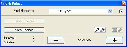

If you added new information into model layers, so that you cannot use layer control to make the selection quick and easy, then you'll have to use Find & Select (etc) to select the 2D elements that were added to the section and then copy/paste.
Just to add to Karl's advice here, a quick way of selecting only 2D info using Find & Select is to remove all choices and just select 2D Types from the drop down.
