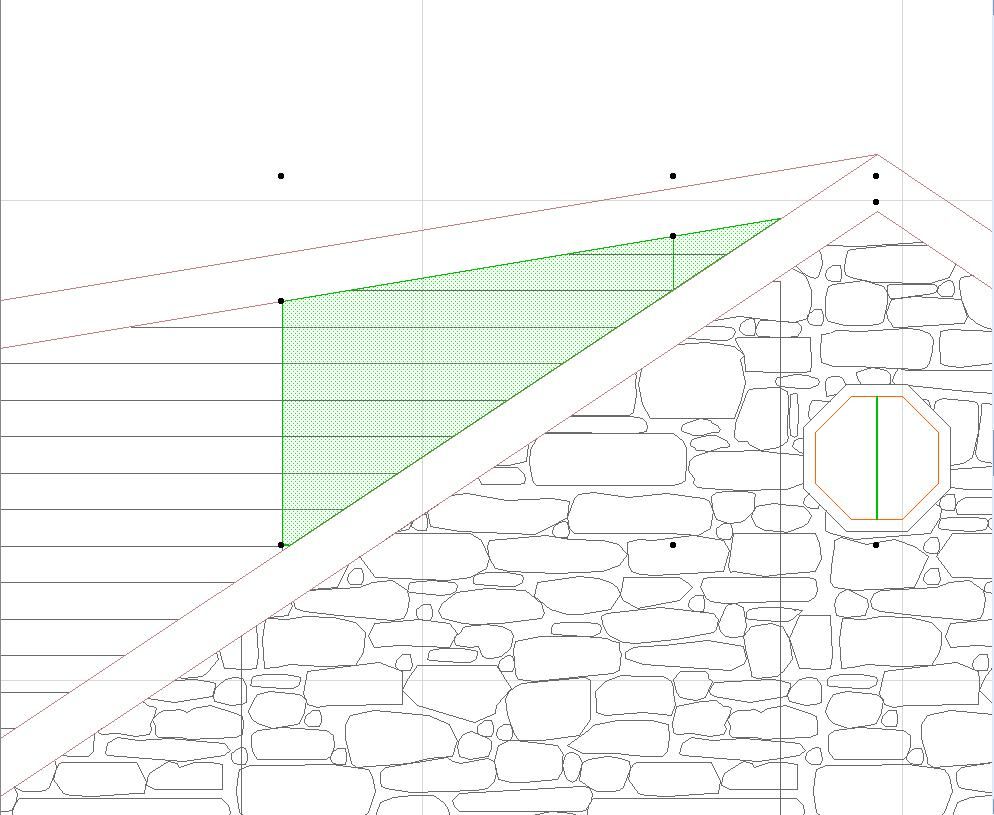

Ive got a little problem that Ive never been able to work out...
When trying to trim the roof to top AND bottom it simply deletes the wall.
I included an example of when I would need to do this,
Any ideas on how to make this work? or another way of showing this wall here?
Thank you.
In the 3D window, select the wall AND the roof you want to perform
the trim with and go to trim to roof and select the type of trim, top or bottom. For the second trim, select the wall again AND select the other roof
and do the second trim. If you don't select a roof as well as the wall
AC does not know which roof you want to trim to so it trims to both
and the wall is deleted.
Peter Devlin
You sir, just got rid of one of our draftsman's (and my) major headaches.
Thank you much.
