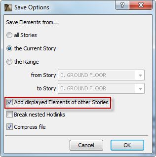

Here is the beginning of a list of 'minor' fixes in AC15 that I was personally involved in. I hope that others may be able to add other undocumented improvements to it:
1. Mirroring text now mirrors the anchor point.
2. The Help menu search function is no longer case sensitive.
3. Fill Area Text's are transferable via the eyedropper/syringe.
4. Project North now accepts up to 4 decimals (when set in working units).
5. Right click on Layouts and Masters to edit their settings.
6. Module Save Options have a new display setting.
Cheers,
Link.
