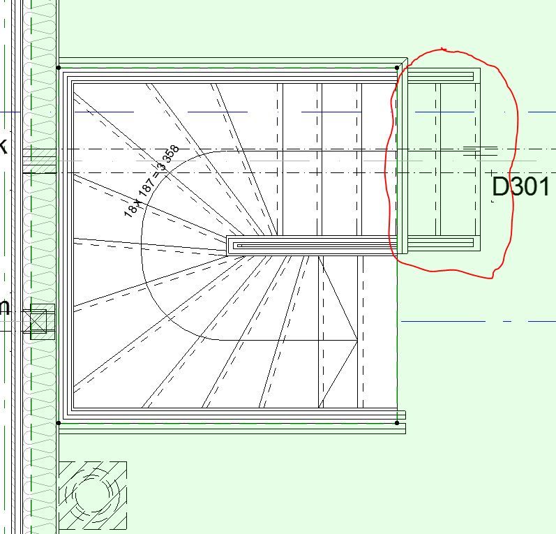

I'm having a problem with my stair.
The stair is covering 2 stories, the image is showing the top floor. I need to remove the visible part in the red zone from the picture. Is there no way to explode the object or cut it?
The green area is my slab on the top floor and i made the stair from the original stair tool.

One option is to add the Cover Fill to the Slab, then adjust the Display Order so the Stair is under the Slab. Another option is to add a Fill over the part of the Stair you want to hide.

why on earth is this the solution? putting a mask on the floor?? Why isn't a floor a solid object in plan? I don't want to see the stair under my slab, and I don't want to start masking in a drawing. Stairs don't show through walls, so why through slabs??

Select the slab and give it a cover fill with white background under floor plan display, or alternatively give your stair a breakline in the floor plan display settings.

As I mentioned in another post just the other day the plan view you see is not a true top down view of the 3D model.
It is a symbolic representation of the extent of your elements (and of course objects have there own 2D script that tells them how to appear).
That is why you SEO for the shafts you mentioned in another post will not show in plan.
By default the representation of a slab in plan has no fill but you can turn the cover fill on if needed.
On or off by default you will never have the perfect solution.
You might want it on for floor slabs as in your case but off for ceiling slabs or bench tops.
Otherwise there may be a parameter in you stair object (depending on what object it is) that will allow you to hide a certain number of top treads from the home storey and a certain number of tread from the bottom in the storey above.
So then when you place it in its home storey and set it to show one storey up as well you can control the number of treads on each floor.

I cant hide the visible steps under slab
Otherwise I need to add a breakline & show only the upper part in 2D above home story option

There is no 'problem'.
Give your slab a cover fill with a white or 'window background' pen as background pen and make sure your stairs are below the slab in drawing order. That way the part you want to be hidden, is hidden by the slab.
Breaklines should also be a good way of communicating floorplan, I would say. Depending on your drawing standards, have one around 1.500 mm above the level of your floor plan for the home story.
