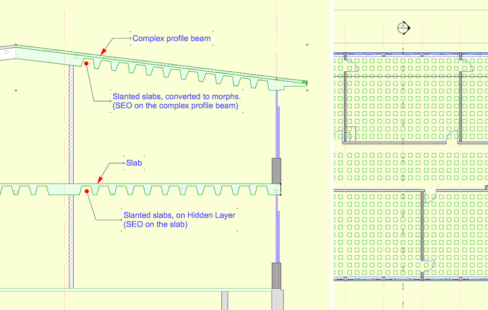

I still am struggling to make a good waffle slab without it being to complicated. Here is what I ended up doing on the attached image.
I heard that the slab accessory could be used to do this but I haven't figured out how to use it.
Well, I don't know how large that Slab is but with lots of SEO it can become slow.
There are a few things you can try:
1. Convert the whole thing to Morph so there are no SEOs.
2. Split the Slab into multiple parts so there will be much less SEOs per part.
3. Save the Slab as a GDL Object, which may be faster.
Good Idea, I will try that.
