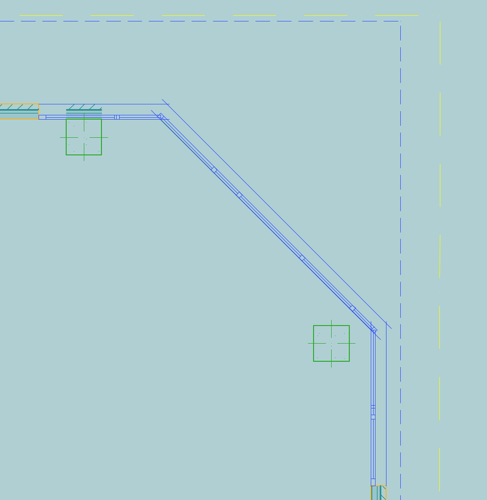

I have two issues currently that have been causing a bit of frustration.
1) When my concrete columns are adjacent to my wall, the column "activates" that portion of the wall to read as a cut condition. This is frustrating when I want the opening in that wall to be continuous, it is now interrupted by this collision "glitch". The building material priority of this column is much lower than that of any material found in the wall
2) I have been building custom windows and my biggest headache so far is the corner intersections between these windows. It seems that ArchiCAD really wants there to be a sliver of wall between window openings at corner intersections. I wonder if there is some easy way to resolve this, currently my work around is to extend the edges of the "WALLOPENING" slab past the edge of the actual custom window. This technique works fairly well, but now I am running into the issue that is illustrated in the attached image. There are now lines running parallel to my window opening that show this "WALLOPENING" extension. Curious that these lines disappear if the sill of the window is at the base of the wall. When I elevate this sill, the lines appear. So now in plan, I have these extra lines, that I can't seem to get rid of.

It looks this might be related to the column setting which activates wrapping the skins of the wall around the column. Select the column and check that the wrapping feature is not on. See screenshot.

Thanks for the response. Since I posted this I worked out the issue with the columns. I don't want the interior skin to wrap around the column, instead I want the wall and the column to be separate entities and not effect each other based on their proximity. I solved this by changing the intersection layer priority of my column layer. By upping it to three this issue was resolved.
Still not sure what the best practice is to make a custom corner window
Another thing you could do is just move the Column a very small amount (like 0.1 mm or 1/64" away from the Wall so they do not touch but on the screen and drawings it still looks like they do)
