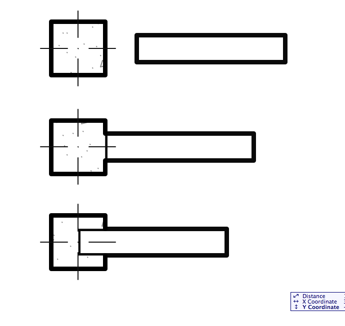

Dear guys:
I got urgent question, refer to image; can anyone help me the figure out the lines. (they not same line weight when column and wall touch together)
I would like to have same line weight ><,

right click on the wall, Display Order / Bring forward

Check that your display settings are set to "True Line Weight" though I cannot make my columns do that.

Tried already, cannot solve.....

I can reproduce this when the 2 elements have the same Display Order, moving the Wall higher in the order solves it here. Or putting the elements on layers with different Layer Intersection Groups.

Dear David:
Still cannot solve it.

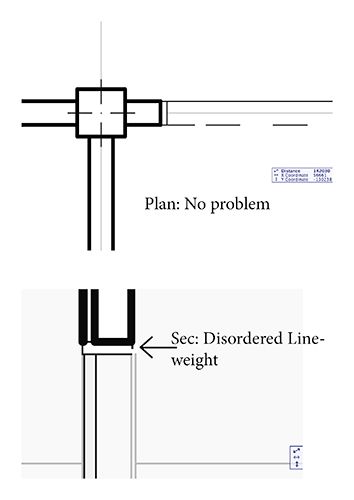

There is another problem also urgent:
Please see the attachment, when I add door in wall, there is no problem in PLAN, but lines get disordered and wall have triple line,
Please help me!

Looks like you are using "composites" for the walls. If so you need to edit the line weights in the Composite window.
