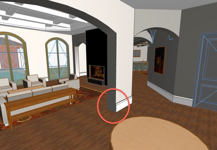

Wall base trim around arched opening
How does one get trim around easily. I know how to do it with profiles, morph, but it sure would be nice if the complex profile would wrap around.

Mark:
If this project is in AC17, then I think you have an Intersection Priority issue between the Wall and the Fill (Building Material) used in the Complex Profile. Try changing the Custom Profile's Fill (Building Material) to a Building Material that has an Intersection Priority that is equal or greater than the Wall's Building Material.
Another option is to use different Layer Intersection Group Numbers if the wall and trim are on different layers.
