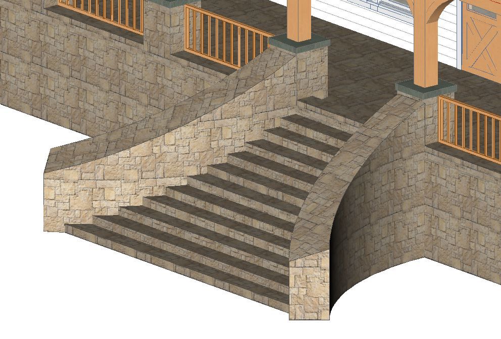

Wall change in height.
Can the curved walls (at the steps) be modeled to slope following slope of the steps? I believe I can do it with the mesh tool but I wanted to do it with the wall tool.

Never mind. I drew a roof and used the trim to top tool and then erased the roof.

A curved ramp might give you a better result. Your method leaves an odd slope across the wall at the bottom end.
Bob Moore
I think you are right. I just noticed the odd angle.
I use to work on a software named Architrion and it let you start a wall at one height and finish at another and I thought maybe AC 11 would let you do that.
