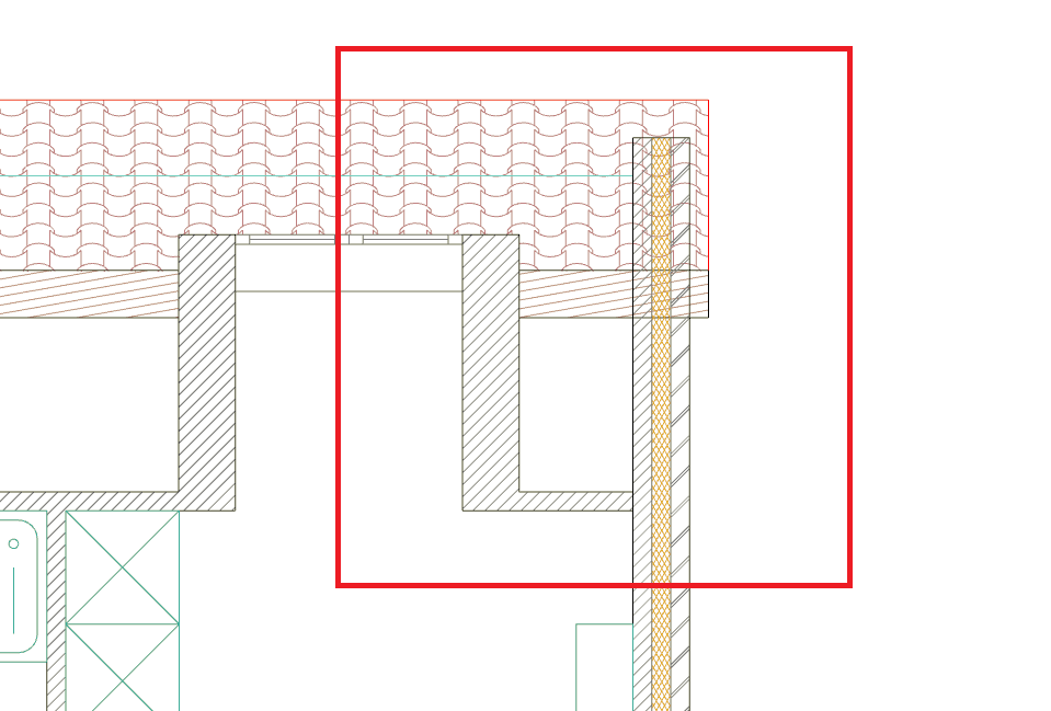

Hi all,
I am trying to sort out the floor plan display for this situation, but to no avail so far. The wall that is under the roof keeps displaying through it. Does anybody know how to hide that part of the wall?
Thank you very much in advance.

Set the cover fill of roof to have a solid background colour (i.e. white or window background (-1)); then use display order commands to bring roof forward of wall.
I like the window background as it is not affected by renovation overrides, whereas a white background fill is.
s2art wrote:
Thank you very much chaps!!! I really appreciate that.
