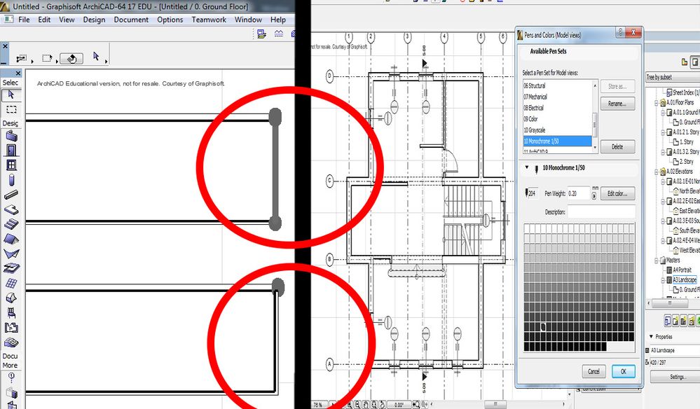

Hi every one, I want to share my problem and try to find solution..
I ve decided to adjust my pen set as monochrome and also their line weight but now i faced a problem which wall end lines are too thick... How can i fix it ?
4 Replies 4
Karl Ottenstein
Moderator Emeritus
Change your wall end line pen to a thinner pen?
And you need to do that in the Composite Structures Dialog.
Just modify the Wall End Pen setting for the various skins.
I solve it only by different way. I had to find pen which used on problematic lines and reduce their line weight.. Thank you for help !
What you have done will work but now you will be hoping you didn't use that pen for any other elements where you wanted a thicker line.
The best solution is to change the pen used for the wall end lines in the composite as suggested before.
