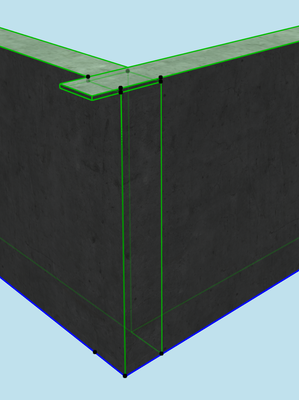

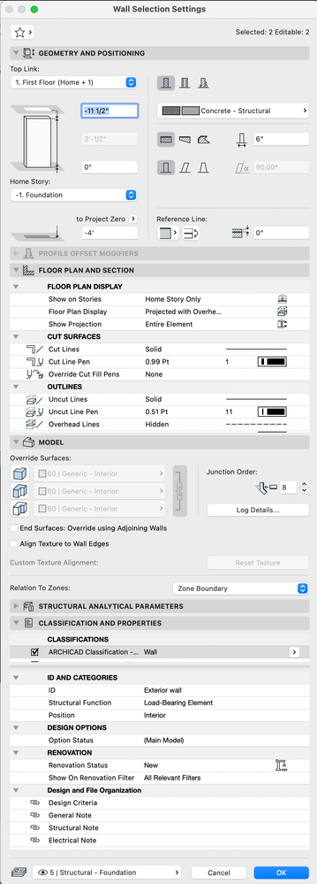

I'm getting these weird intersections between walls with the exact same makeup. This one is very basic as an example.
Structure: same (basic)
Material: same (concrete)
Thickness: same
Wall complexity: vertical
Top link: same
Home story: same
Reference line: same
Layer: same
What can I check to resolve these oddities?
Thanks for any guidance!

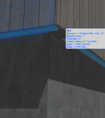

proto
There is a complex wall above that shares a reference line in plan position only.
The lower bounds of the upper complex wall has been dragged to overlap the top of the wall so that the materials interact in section.
Is this the source of my weirdness?
Mac ACv29.2.0/5003, US, Tahoe26.5.1, 2021 iMac//2023 MacBook Pro//2025 Mac Studio
proto
view from sunny side for better image of interaction
proto
section
Ahmed_K
Mentor
yes, that's the source of the problem, wall should not overlap vertically on the same Reference line position

proto
what are people doing to resolve this condition?
i thought i was using the interaction correctly to get the sectional relationship correct
is it enough to define the lower wall ref line as "inside core" just to get the two ref lines apart?
Ahmed_K
Mentor
that depends on the situation , can you share clear screenshots of what you want to achieve please ?
