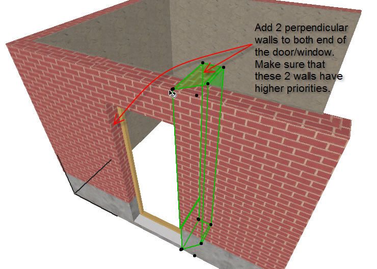

Wall profile, how do you get sides of opening to wrap up?
See attached image, this is done with a wall profile, is there a way to get the profile to wrap up properly around openings?

This is what I was trying to achieve with the complex profiles. I ended up using separate walls, slabs and empty openings to achieve these walls and had to make sure all these elements where changed whenever the design changed. Too bad complex profile isn’t yet mature enough to be usable; it would’ve made the design process so much smoother.
I don't know if this would help.....at least this is how i would do.
