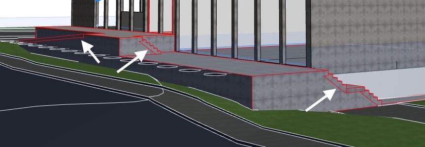

Hello everyone, I have a small question about connecting walls and stairs / ramps. I have some poured concrete stairs and ramps that will have the same rendered finish as the walls around them.
In archicad I did a SEO to the walls and stairs/ramps to achieve the form that I wanted but there is always a line between the stairs / ramp and the wall meaning that Archicad doesn't connect them.
Is there a way to make the walls and stairs connect?
Thanks in advance and kind regards,

Stairs and ramps are objects and even if the surface of a wall and an object are in line there will always be a joining line between.
The easiest way I can think of to hide it in 3D is to place a polygonal morph (line) along the join with it set to a white pen colour or maybe a similar pen colour to your surface.
Thanks, will try your solution !
