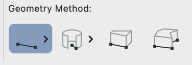

When using the wall tool, all geometry methods are not avaliable. When choosing the straight line tool, there is no other options showing, and thereby I cant find the option for chained walls. Does anyone know how to solve this problem?

I'm not sure if I've understood the issue correctly.
But you need to press and hold on the icon for the other option to show. Or you can, with the wall tool, active use shortkey G to cycle through the geometry methods.

Yes, it is a slow click rather than a quick click to bring up the geometry alternatives.

Thank you. the press and hold did not work, but the shortkey worked! Thank you.
