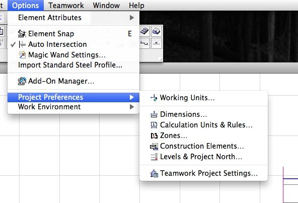

Master wrote:
you have turn on the option 'Update Auto-rebuild Model viewpoints continuously' in Options/Project Preferences/miscellaneous.
I do not have that option there. I have to go to work environment/more options to find the "update Auto-rebuild Model viewpoints continuously"
Steven wrote:
Maybe the gnomes that live inside computers running them are napping...
We have hamsters on wheels in ours, maybe we should upgrade to muscle-bound squirrels?
Steven wrote:
That option is in Options > Project Preferences > Miscellaneous (at least in AC11)
This is my menu in AC13. Looks like the location changed. Or my menus are screwy!
No worries, GS changed the position of these options, I think they had there reasons. But is the option on or off?
The option is on, as is the auto-rebuild.
