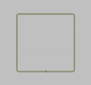

Kliment,
Can you please let me know how you made that downspout with a profiler?
Thanks in advance.

lec1212 wrote:
I believe he made a profile of the side view, and then extruded the width.
That's how he got the bump around the cornice.
May be, but I am interested to know how the hollow inside was done if that was a complex profile.

I can't speak to how Kliment is using complex profiles for a downspout with offsets but doing a hollow is no problem. Just make your fill for the profile and then with the fill selected use the fill tool to cut out an appropriate interior form - just as you would with a slab or fill in plan.

I used CP because I wanted downpipe to be hollow and have a square section with fillet. So I got the contour line of the downpipe from section, copied it to plan and magicwanded it with a CP wall. Then saved it as a LibPart.
