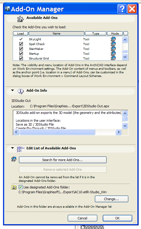

did you check this box ?

I'm trying to add it to a Scheme for a custom Profile. The addon box is checked... yet I can't find Spell Checker to add it to the new scheme.

Work Environment>Command Layout Schemes>Menus...
left-hand well:
'All Commands by Theme' then '16 Add-Ons'. the spell checker menu and commands are held in there. make sure that you have a open menu in your right-hand (menu building) well otherwise the commands will appear greyed out (like in the screenshot below)
