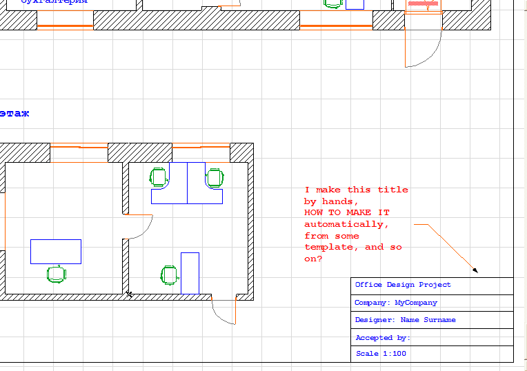

Please help me make entire drawing title (or maybe label, dont know its name in ArchiCad..)
I attached picture, hope it helps...
Currently, I drew it by hands. But I want to make this frames(?), labels(?), titles(?) automatically, or maybe (dont know..) using some library parts.
Please help, where to look? How to accomplish this?
Thanx in advance...
1 REPLY 1
The short answer is-- Insert Autotext
http://www.graphisoft.com/products/archicad/ac10/ITG/
first fill in the information: Click File-Info-Project Info.
Then when you add an autotext it will use the information you added there.
