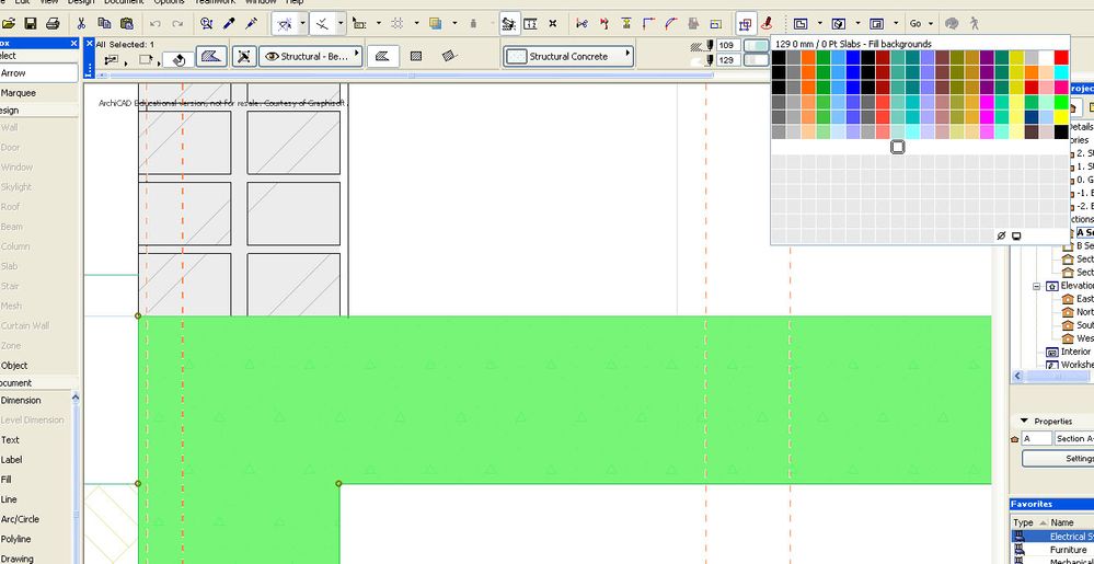

White fills show up grey
I'm not sure what exactly has happened here. I'm pretty sure I didn't do anything, but I must have done something.changed some setting by mistake, because all of my white pens show up grey. I'm using Archicad 12, Student Education version on Windows XP. I've attached a screen shot. As you can see my pen set says the fill is white, but like the brick workabove, the highlighted concrete fill is showing up with a grey background. Anyone know whats happened here?

owen
I was going to say check you haven't accidentally turned on Uniform Pen overrides in the Section tool but just noticed there are some green pens at the edge of the screenshot so that can't be it (assuming this is a pure model cut, no manual lines)

Solution
owen
and the correct answer is:
Automatic Pen Color Visibility Adjustment
go to Options > Work Environment > More Options and make sure it is unchecked (second from the top). This setting basically temporarily overrides any pens that would not be visible due to the screen background color (so white on white or black on black)
cheers,
Owen Sharp
Design Technology Manager
fjmt | francis-jones morehen thorp
iMac 27" i7 2.93Ghz | 32GB RAM | OS 10.10 | Since AC5
Perfect!
Thank you Owen..
I have no Idea how that got checked, but it was..
Problem solved.
Thanks so much for your help.
