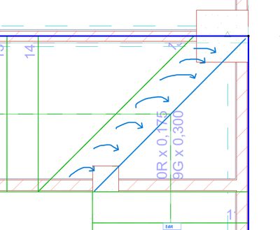

How do I move that slanted green line to the blue line I’ve drawn there? I’ve pressed loads of buttons and it hasn’t worked; I’m stuck.

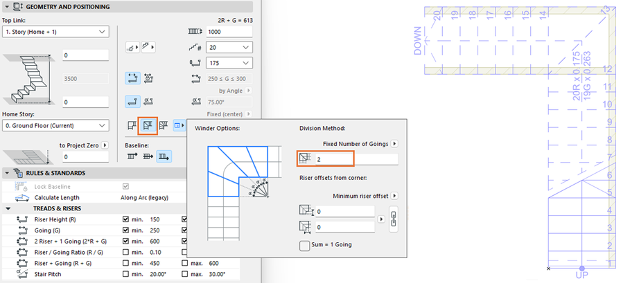

Watch the attached images and GIF with the whole process.

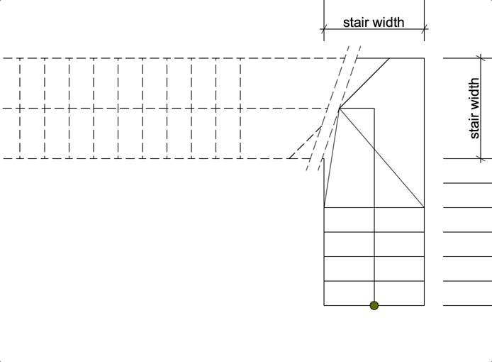

Afterward, you can still modify the staircase. Adding some guide lines at the width of the stairs helps.
You cannot go narrower than the staircase itself, which allows you to snap to the minimum width.
