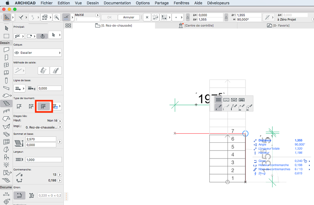

Hi all, sorry if it's been asked before, I couldn't find it and I've searched all I could in the stair tool today. Any tips as to how to create this, please? Many thanks for any pointers.

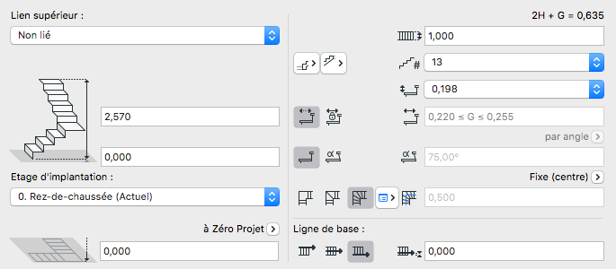

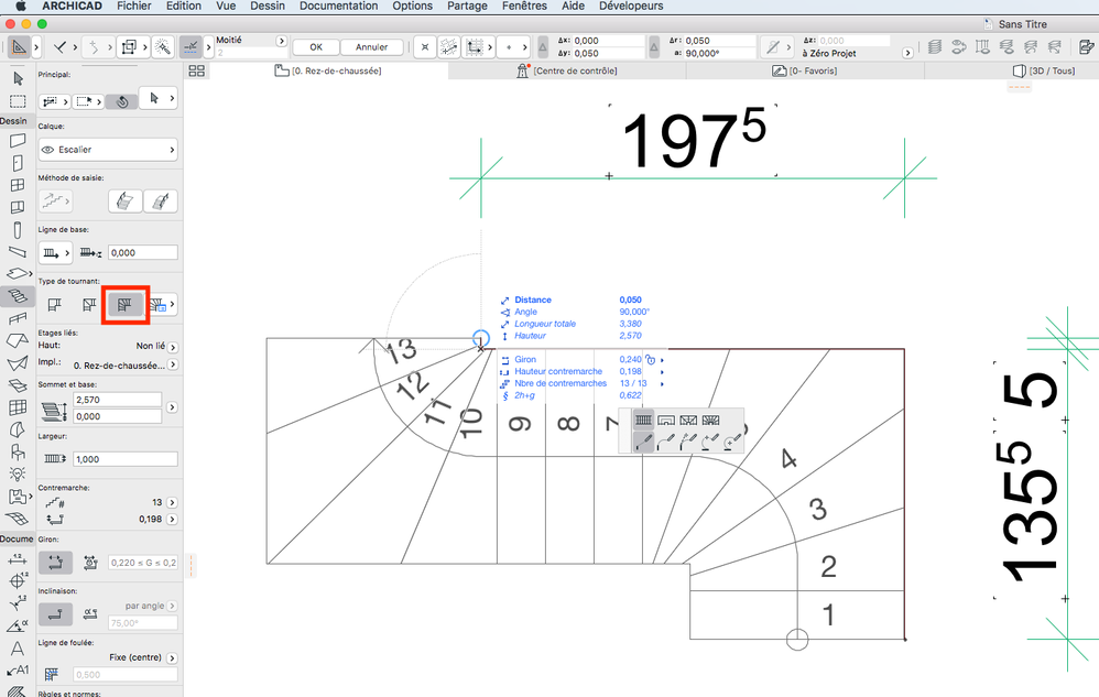

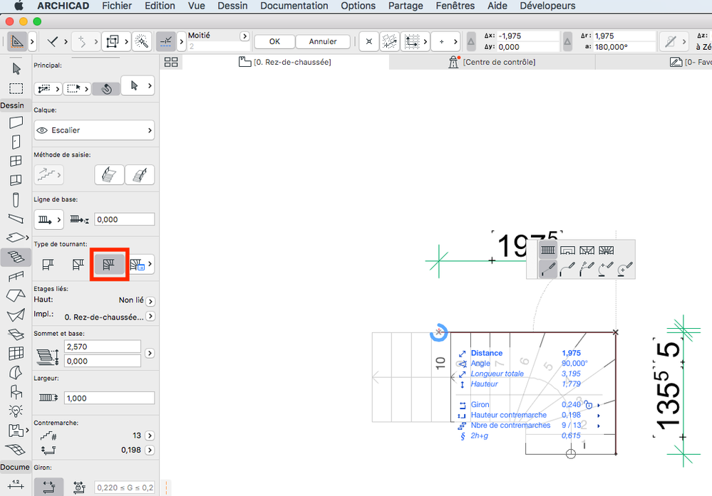

Hy,
It's not exactly the same but pretty similar.
