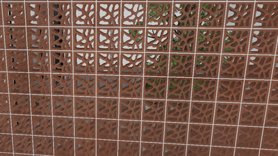

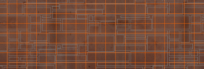

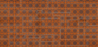

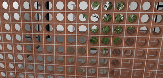

Good afternoon,
Would like help with the 2d representation of the cogobó, a type of window.
If i use one of the pre made models of Archicad the 2D is the same as 3D
But the one I made its just squares
How can i change the 2d?
Thanks for the help

I assume the second image of the pairs is a plan? The 2D of objects is drawn seperately from the 3D. You could use Project2 or simply draw what you want in the 2D Symbol of the object if need be.
