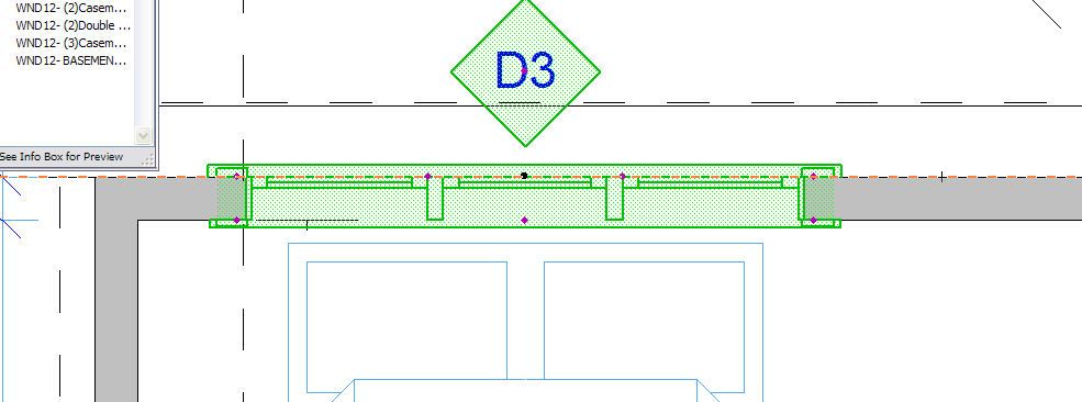

Window Dimsensions
The little purple dots are not at the outside edges of frame and are off set by some amount.
These are what the dimesions go to not the value I entered for the horizontal window size.
Rough opening extra value is set to 0 and this only happens on these multiple casement units- so far.
Hoping there is some v10 parameter I am missing. . .

FYI
If this ever happens to you it will fix itself by simply
dimensioning to the purple dots in the wrong spot.
select the window
change the width to some other size (the dots will appear on the edge of the frame in the right spot)
Rechange the window size back to the right width.
I think it might be from editing the window sized inside the interactive schedule.
Thanks for posting your solution. Mine was happening even after applying my window favorite to it. Never changed size in the schedule though.
It did resolve itself when I changed window size.
Thanks.
