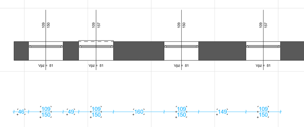

Hi

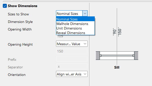

I want to set a size of window to show in dimension line (one of the below).
However, when I do change this, they all show the same (every window has a different "sizes to show" option selected):
How can I change that?

Would you not want the dimension line to show the wall opening regardless of any other setting?

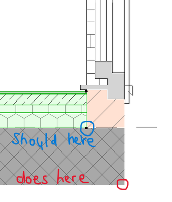

No, I do want to show it. Maybe I should word it differently:
I want to learn how to change the settings so I could choose what the dimension line shows.
The current problem is that dimension line shows a different sill height; the height from the bottom of concrete, not from above.
We checked where the wall is positioned, the settings of the window, the slab settings, and everything is as it should be.
So we wanted to look inside the settings of dimension line but got stuck.

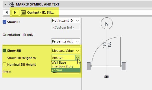

The dimension line can only show the height of the opening, not the sill height, Lingwisyer has shown you the dimension settings for that.
The marker can show the sill height and has it own settings in the window settings ...
