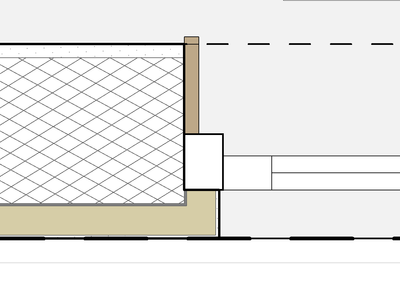

Plan view where the insolation turn inside

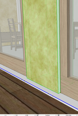

This image in core only view shows how the insolation didn't turn on 3d

You can use the Search function at the top of this page to look for posts related to this... and find dozens of posts over many years.  This is a long-wishes for feature that has yet to be implemented.  It's very unfortunate as this affects projects of every size and yet it is not on the roadmap.  You'll have to use one of the workarounds in those old posts to get the 3D and Section views to appear properly.
