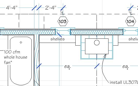

So...as there was no good insulation line-type for use in plan (as is our office standard to do), I made a nice looking one. PROBLEM IS, when I take it into PM to do a little linework and editing, and explode the drawing to manipulate it, the insulation itslef EXPLODES to what appears to be its "true" width, eg 5 1/2", rather than about 1/8" which is what I want at 1/4 scale... any ideas as to why this happens, or how I can prevent it? Did I maybe make my line all wrong?

Sorry to get a little off original topic, but 'keep it up" is the main message here. Your line scale issue might be to do with "scale with plan" or "scale-independent" setting when you create your line type. Experiment.
