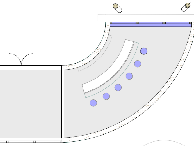

Me and my co-student both use Archicad 27. But after we send the file to each other all the objects and windows turn blue on the ground floor. This only happens to the objects we place after the exchange of the file. What can i do about this?

Are you using the same pen set?
ThomasvandePol
Yes everything is the same.
I just changed the objects in to morphs and now the color is normal. It helped but i dont think it is the right way.
Ricardo Heim
So maybe Archicad is creating an issue for those changes, and the issue comes with this 25% blue graphic overwrite, you can go to the issue manager and chek if it has an issue
Or the objects are classified  or have an ID that your graphic overwrite is filtered to, changing the background fill pen.
Or is just a bug that i don't know of 😅
