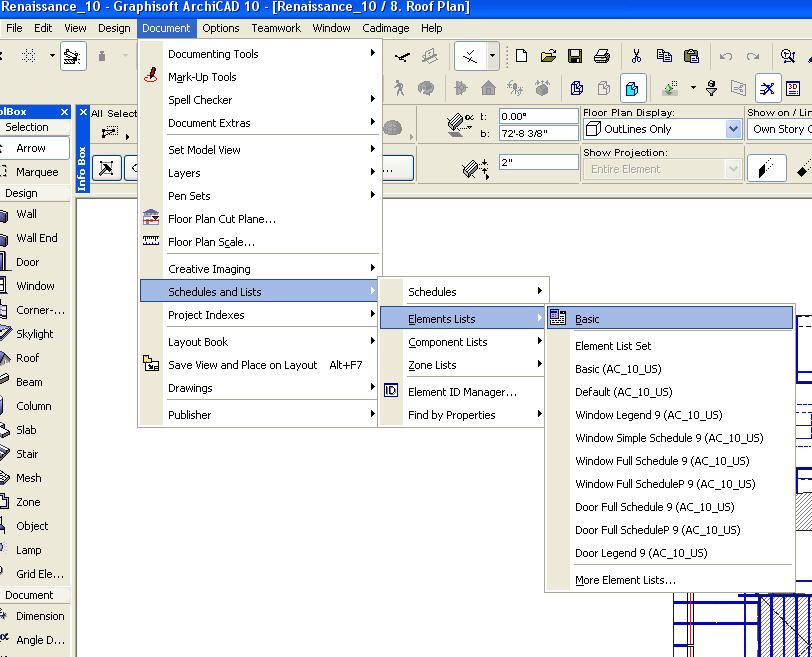

I have tried the Window/palletes/Element Info path and selected the "area on plan" button. It calculates each roof plane without showing an overall sf of all roofs selected. I guess you need to manually add each roof plane to get a total. This seems way to complicated.

Rich, Just select all of the Roofs you want a calculation of and then select the Elements List / Basic shown in the attachment. It will give you the total.

That's it!!!! Thanks Gerald for taking the time to set me back on the road. Really appreciate.

The Basic Element List will give you the area of the roof surface, not the 'Area on Plan', like the Element Information will. There's a difference, so be careful.
I am not sure if there are any 'Area on Plan' parameters available in List Schemes. So to answer your original question, no, not AFAIK.
