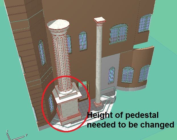

can i control the height of pedestal of column ?
Hi every one , i chose from archicad library type of column which is column architectural 15 (noting the diameter do not change the height it change the width only) now i want to make the height of pedestal is specific how i can do this to suit my design and thanks
1 REPLY 1
Erich
How about using the column without a pedestal and then using a complex profile wall to make the pedestal...
