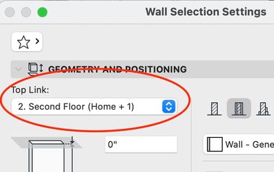

Karl Ottenstein
Moderator Emeritus
You cannot change the height of a wall that is linked to another story.  You have to set the wall to unlinked and then you can dynamically adjust the height and will see additional items in the pet palette.
