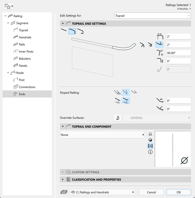

For instance, I only want to make 90digree in one end and keep the straight in another end. But I didn't find way to setup

I don't think this can be done during setup. Set the rail end parameters for one End, then after the railing is placed, select the railing, click the Edit button, then select the other End (on plan or 3D), open its settings and change them to suit.

Hi David, thanks for your support, it's done by your help. And I updated my signature
