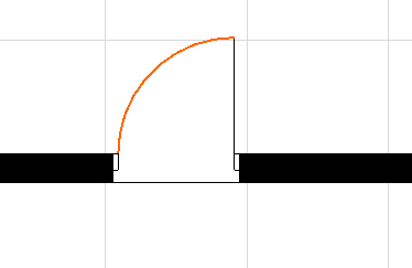

where can i change the red colour to black?
i went over options 5 times, changed every colour, but i cant find it...

U have to do this : select the door , then settings, then go to "floor plan and section" , symbol and outline, and uncheck "enable object's linetype" and "enable object's pens" and now change the colours.
i have another problem: is there any way to get rid of that orange lines as in this image ?
thanks for the help...
and yes, i want to know how to get rid of those lines... but i think they have to be now... some new rule or something?
I also want to know how to get rid of those lines. The 3D view: The direction of the 2 lines represent the opening of the window... You can remove them, I'm just not sure how.

did you figure out how to change the orange line in plan? if you are working in AC13, that option is no longer in the "floor plan and section" settings. it is now in the model view options (alternative for GDL objects in ArchiCAD library 13) as a global control over the arc in all door symbols
i cannot find where to turn off the diagonal opening lines in 3D

It is all in AC13 new Model View Options Combinations for GDL objects. This way you set this option different for each view.
so there is not way to get rid of that orange line ? or...

mlegs wrote:
/.... is there any way to get rid of that orange lines as in this image ?
Assuming you have Ver 13 then open Model View Options and you will see there what you ask.
Just remember to save your view set,
