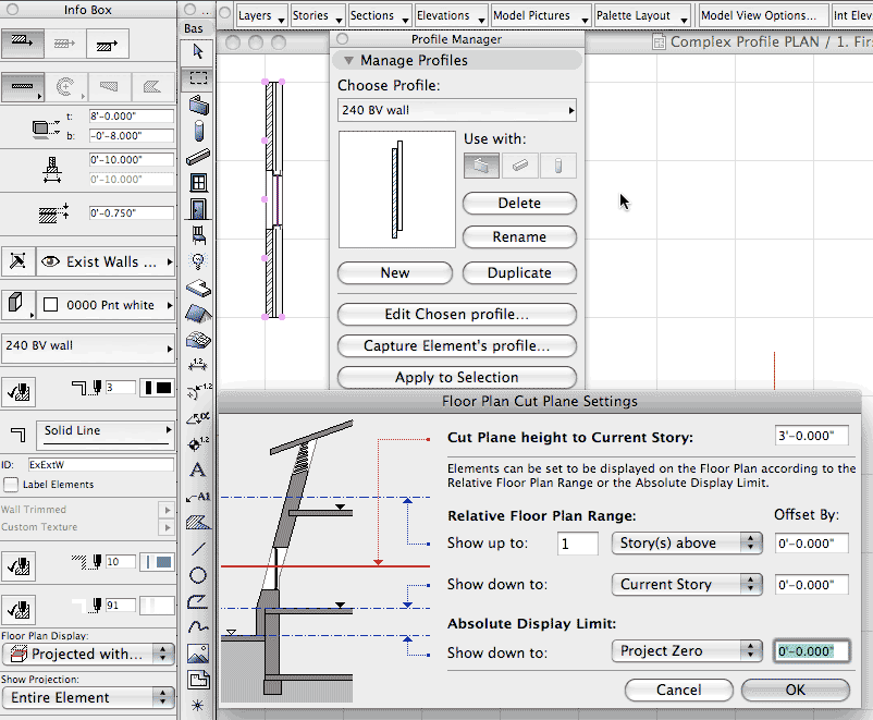

I have tried to set the cut planes to different heights and nothing happened. I also notice that when i placed a window it shows up in the 3D view but not on the floor plan. Screen shots of wall below.
Thanks for your time
Cheers
Kev:
I tried to replicate your wall, and it works here (see screen shot below) so I cannot see why this set up does not work for you. You could try looking at Model View Options > Override Fill Display > Override Cut Fills, but as your other wall is showing its fill, I doubt that this is the issue. To me, it looks like the Floor Plan Cut Plane is not cutting through the wall, but I cannot see why according to your screen shot. (When I change the Floor Plan Cut Plan to 10'-0" (above the top of the wall), the fills and window disappear.)
For the window, check to see that in its dialog box, under Floor Plan and Section > Floor Plan Display is set to Symbolic, then it should show as long as the Floor Plan Cut Plane is anywhere through the wall (even if it misses the window), unless again under Model View Options > Options for Construction Methods > Window Options is set to Hide on Floor Plan.
Sorry to not be more definitive.
David
