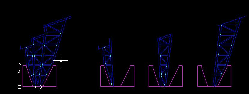

I'm tryin to create a curtain wall as shown. Is there a way to move each line in the curtain wall system? so far i can only set up a grid and move the grid. It will be three different curtain walls because the facade is not flat.

That's my mistake. I meant the way the grid lines are in the picture not the color.
grid line of curtain wall? do you mean the frame??
you have to edit in 3D
THE GRID LINES AKA THE CROSS BRACING. THEY ARE ALL AT DIFFERENT ANGLES. IS THERE A WAY TO FREE EDIT WHERE LINES GO TO ESTABLISH A DIFFERENT PATTERN.
Do you need to specifically use the curtain wall tool?
You could do this by drawing the shape as a complex profile then extruding its depth.
You could also use the trussmaker tool and set up the different thicknesses of member with various colours of line.
Just thowing some alternatives out there! I have no preference, it's just what works best for you.
My point is that your screen shot is totally black. You can't see anything.
As Peter said, the structure that you are looking for should be done separate from the curtain wall.

rocorona
Necko, you do NOT need the CW grid to follow exactly your drawing. You can place CW Frames as you like, editing the CW in the 3D window, and then choosing the Frame tool.
Just try...

I now know his concern,
Even though he can edit the CW in 3D
but it is very different to trace the CAD drawing and make a totally the same type of curtain wall.
I am still trying now
