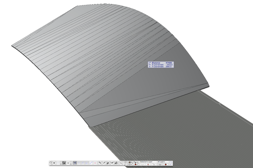

I've curved roof built by 'mesh to roof' . 'the mesh to roof' generate that roof become segmented. is it possible if i draw curved roof not in segmented (one part curved roof)?
then i'll using cadimage roof builder so my curved roof have looks like simple roof as image i attached.

Not as a roof.
You can use the Profiler, or a Custom profile wall or a beam.

Also not as a roof - but it appears that the curve on one side is different than the curve on the other. The complex profiles cannot create such an extrusion - however Cigraph's ArchiForma can, and I suspect that Objective and Cadimages profiler might be able to as well?
thanks
Using the mesh to roof creates a LOT of roofs. Cadimage Accessories will place a unique object for EACH of them. I'm not sure that's what you want.
