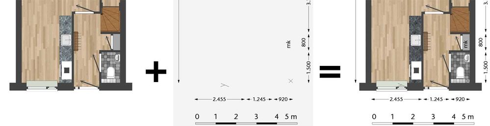

In our final layout we also want some dimensions, lines and text.
Now I make an second view with only the lines, dimensions and text and put it on top of my 3D view on a layout.
Is it possible to put lines, dimensions and text in a 3D view without losing texture?

Thanks for your method. I have considered this method.
This is like my current method, a complicated manner.
Again I must perform various operations for the final result.
If adjustments are made, my textures again have to be adjusted or aligned.
