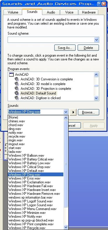

disabling sounds - how?
i have a really stupid question:
how do i disable sound in archiCAD 9?
ex. when i'm using alt to pick up settings of an item in a project...
i searched help over and over again, but with no results...

I think you'll need some plist exercise. Somebody should know. In AC10, it's a simple workspace preference toggle.
If you are on Windows, go to Control Panel > Sounds and Audio devices and edit in the list on the sounds tab. You can alter or turn them off (under the sounds pulldown, select (none) ).
HTH
thank you so much!
i would have never thought of looking there...
Thank you, thank you, thank
Everybody in the office is cheering!!!
