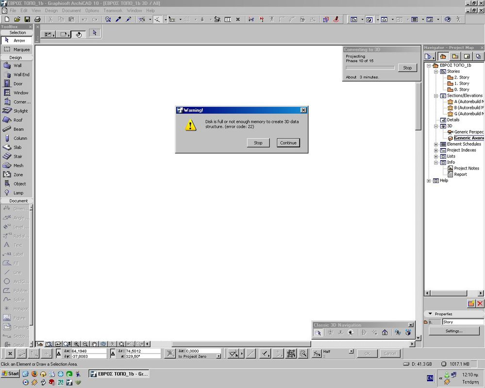

error in 3d
i get this error when i try to see 3d
big project too many trees.
what should i buy? RAM? vga card? or clean up the hard drive??
down on the right you can see my free 'things'
really need some help here
thank you everyone!

You need more disk space for Archicad's temporary files. These files are created distinct from the actual project file when a 3D view is made.
You can see where Archicad places these temporary files by reviewing your preferences and/or work environment.
In all probability, and the easiest solution, you need to ADD a hard drive. Then change Archicad's preference to this drive.

its not that d 40 GB that appears at the bottom of my screen?? or it is that and i need to have more?

It is either a huge 3D file because of the foliage, or there's a corruption of an element that generates false data.
You could invest time in locating a possible corruption but you already seem certain that trees are causing the huge file....

yes i think the problem is the trees
so if the disk space is the problem i must ask again how much more space than the existing 40 GB i need?
or that number down there does not refer to that?
