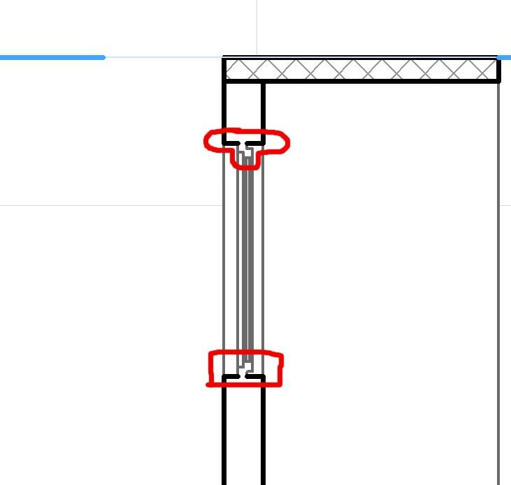

Wall line cuted by window
I never noticed this before.
How do you get full wall line, so that its not cut by the window?
2 REPLIES 2
TomWaltz
It's probably because the window and the wall have the same cut fills. Archicad removes the lines between such things because it thinks you want them to clean up.
Try changing one or the other's cut fill.
Tom Waltz
Thank you Tom
That did the trick.
