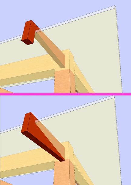

My coworker was attempting to use a soffit (slab) to SEO subtract out a chunk of rafter (roof). After selecting the appropriate target and operator, and pressing "execute", the selection fields cleared (revert to zero), but nothing visually happened.
I moved the soffit and rafter down in the model, and voila! SEO action.
I left the rafter in the lowered position, and moved the soffit up until it failed to perform...please see the attached image.
I guess the soffit is interacting with something else in the model which prevents its functioning as an operator? I don't know.
Has anyone else experienced this? Any thoughts on what gives?
Thanks v. much,
John

I just had a similar problem trying to subtract slabs from a sloping beam for a stair (timber treads subtracted with upward extrusion from the sloping stringer).
Nothing happened until I moved the treads to be completey below the stringer - then the SEO appeared.
Move them back up and the SEO stopped working.
Exactly the opposite happened for downward extrusion - the slabs had to be completely above the beam.
I thought it must be something to do the the beams priority strength.
Changing this strength made no difference but putting the beam in a different layer to the slab worked.
But the layers must have different intersection priority numbers.
Barry,
Bingo, exactly right. I changed to intersection priority of the soffit and pow! Perfect.
Thank you.
Still, I've not had to do that before, and I SEO my layers with the same priority numbers (roof and walls and stairs and floors, all on different layers) against one another all the time.
And why would it have worked earlier when in a different location?
Mysterious to me, but I'm grateful to have this as a solution.
